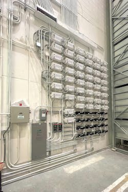

    A primary design criterion for the high-bay luminaires was the ability to remotely access the LED drivers for regular maintenance. In some cases, the drivers would be located up to 200 feet away from the fixture, ganged into an array of 64 driver boxes on the wall alongside the archive storage area.
    With that determination made, the general lighting was designed for overlapping coverage from the existing layout, allowing half as many lights to be in regular use, with bi-diem cycling to reduce burn time. The output was overdesigned to dim to 40%, enabling the system to ramp up the setpoint over time as the lumen output depreciates. The lifetime of the new lighting system is estimated to exceed 30 years.
